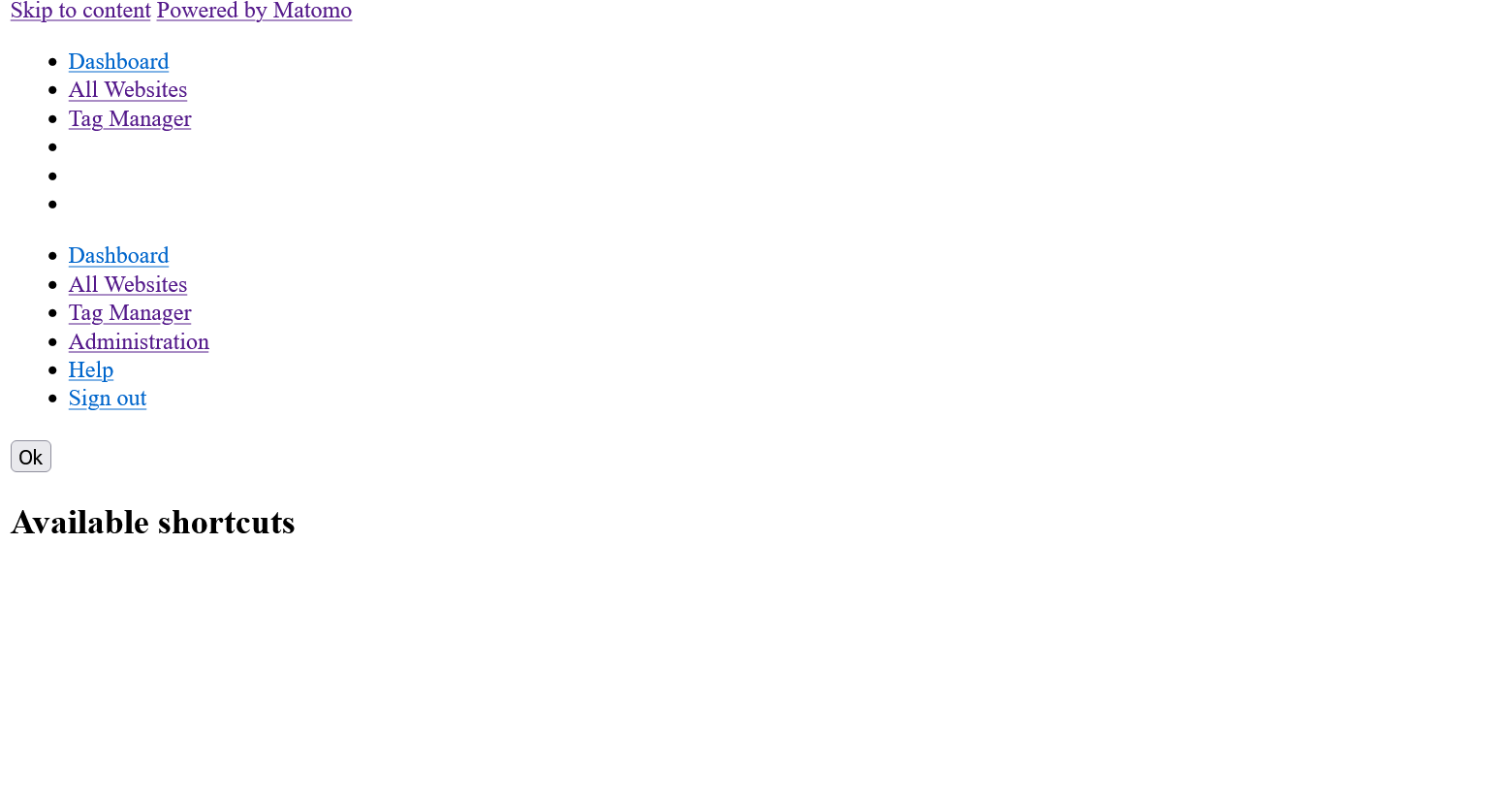

Matomo Website broken
I see no errors in Networkanalysis as above… only in Console as above that

My admin tells me:"I don’t see any stylesheet requests arriving to the server from the page I landed .. "
"yep … not sure what happened it seems like the stylish part of the code is inactive … when I inspect the source code of the page I see no CSS instructions from a virst view … I am still digging though …
"probably yes … which proves the theory of auto updates of piwik that most of the users tended to have issues after … "
"I see no significant or related errors in the error log that can lead to such an issue … and most of everything I see no css requests in the access log … which leads me to the conclusion that either those are being sent to another server and cut of as a cross site script attack … or they to not exist at all … and when I also debugged the html code … saw simply no css instructions at all … "

Okay, I can reproduce the issue when accessing your server and I think I know what goes wrong.
When accessing /index.php?module=Proxy&action=getCoreJs Firefox just gives a general “Content-Encoding-Error” without more helpful information. Chromium shows net::ERR_CONTENT_DECODING_FAILED which brought me to
Weirdly enough curl https://piwik.yourmatomo.example/index.php?module=Proxy&action=getCoreJs works perfectly fine. But this brought me to the solution:
When a client requests that the server sends the respond compressed (which all browsers do with a Accept-Encoding: gzip, deflate, br header), your server responds that it compressed the response with gzip (Content-Encoding: gzip) but the actual data it sends is not actually compressed but still plain text.
You can reproduce this with curl -v https://piwik.yourmatomo.example/index.php?module=Proxy&action=getCoreJs -H 'Accept-Encoding: gzip, deflate, br' and you will see both the Content-Encoding header is set and the response is still plain text.
Or you do a curl https://piwik.yourmatomo.example/index.php?module=Proxy&action=getCoreJs --compressed where curl fails to decompress the stream as it is not actually compressed.
* Error while processing content unencoding: incorrect header check
* Failed reading the chunked-encoded stream
As to why your webserver would do this, I can’t give a clear answer, but I would check your Apache config exactly (especially the parts related to gzip and compression). Maybe something is set up strangly there.

Thank you, that was the key clue.
The option
zlib.output_compression=1
was the problem. zlib.output_compression must be deactivated.

To everyone who had this issue (@Dan70, @nfc, @rkids):
Thanks to @SteveG we now know the source of this issue:
My description of the issue in Matomo Website broken - #30 by Lukas was correct (only the JS/CSS requests return non-gzipped data, but claim that the data is gzipped), but the issue is in fact not caused by a broken Apache setup.
Instead, this is a bug in PHP (versions 8.0.17, 8.0.18, 8.1.4 and 8.1.5):
https://github.com/php/php-src/issues/8218
So the proper fix is to update your PHP version to one that is newer than the listed versions.
It turns out there is currently no newer version of PHP, so for now disabling output compression is the only solution.
