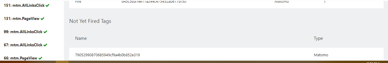

When checked in Preview/Debug Mode, and we are encountering the aforementioned issue ; the tag is getting fired and the trigger has some long alphanumeric string.

Very strange that the name of the Fired tag…
What is the content of the Not Yet Fired Tags list? (does is contain only unnamed tags or do you see their name?)
What is the behaviour of the Not Yet Fired Tags list as you fire some triggers?
When a tag is fired twice or 3 times, what do you see in the Triggers tab of the debug view?
When this issue occurs, in debug mode the trigger only shows the trigger type.
Not Yet Fired tags also show the same alphanumeric string.
When the tag is fired multiple times, the trigger only shows the trigger type.

I see several mtm.PageViews in the events logs (on the left of the debugger).
I think your behaviour may come from this… The I deduce you are in a single page app.
