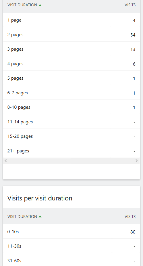

Hi Matthieu, now another try to describe our problem:
I use a segment visit per duration 1-10s and there are lots of visitors who were able to visit more than 1 page:
When I check the visitors log for the visitors who visitet 3 PAGES it looks like this:
So it realy looks like Matomo is counting the actions from the tagmanager als page visitis.
