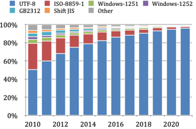

Your problem isn’t with Piwik or the database. The tool you’re using to inspect the database contents is displaying the data in ASCII instead of UTF-8.
Here’s the Wikipedia article that should explain what you’re seeing:
