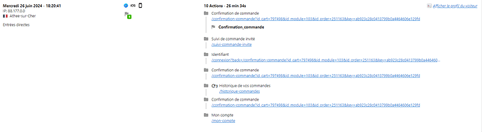

After, few hours later, i can see the confirmation-page appear in the visit log
But the IP is not the same, even if an explanation is possible.
It seems that the purchaser has begun another session at 18:20 with the confirmation-page but I can’t see the E-commerce Order here ( price and product name)
And mostly I’d like to relate this session to the previous one if possible to facilitate reportings particularly;
