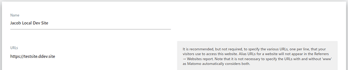

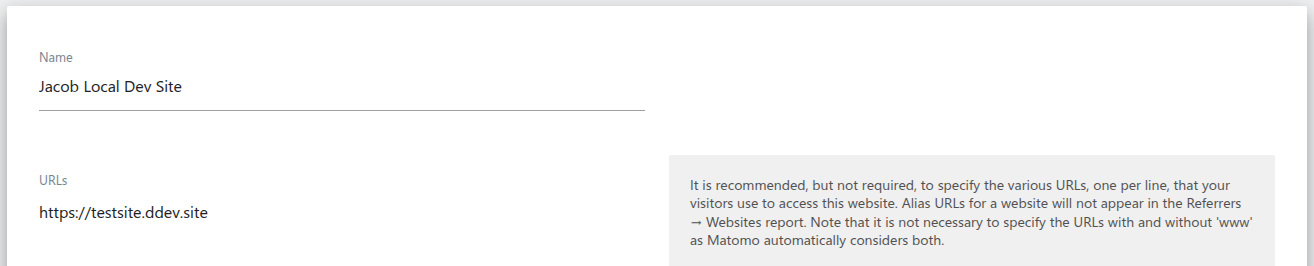

Sounds good @E111 . Support should be able to provide some guidance. I think you’re right. It sounds like you’re trying to change the tracking URL:

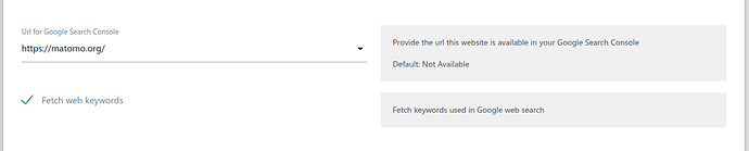

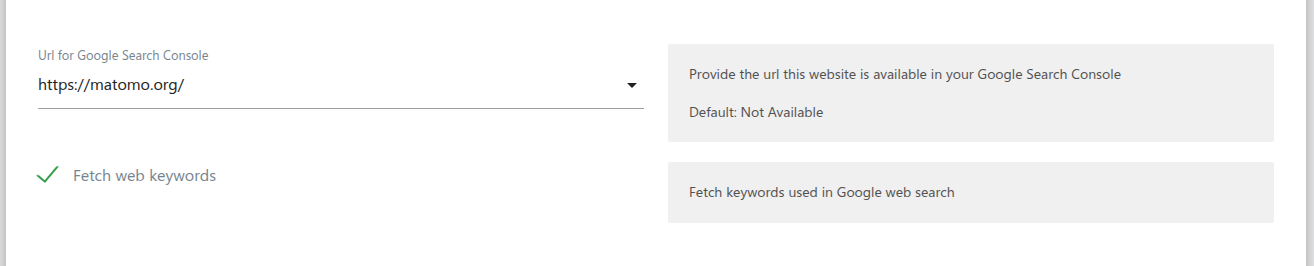

While the error appears to be coming from this field:
Is the account you’re logged in with authorised to access the URL selected in that field? It shouldn’t matter as you’re not changing it, but it might be worth checking. For example, my organisation has granted access to matomo.org for the email account I authorised in Administration > Settings > Search Performance.
