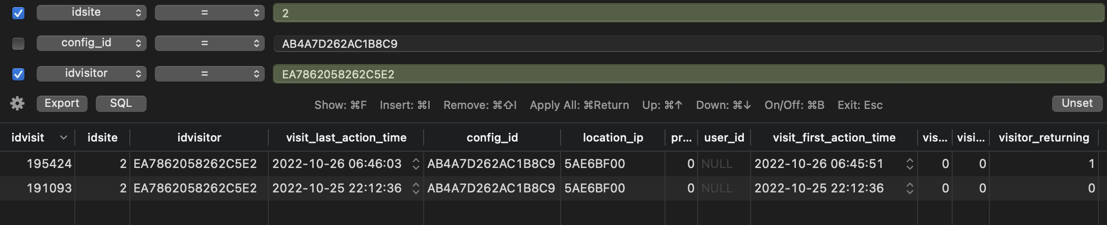

This is from my matomo_log_visit table. I can see that the browser with this config_id has made a visit on 2022-10-25 and on 2022-10-26. Also the idvisitor value exists and that is also unique.
I would have hoped that when generating the summary for 'week" that this config_id/idvisitor would count as 1 unique but it seems it is counted as 2.
