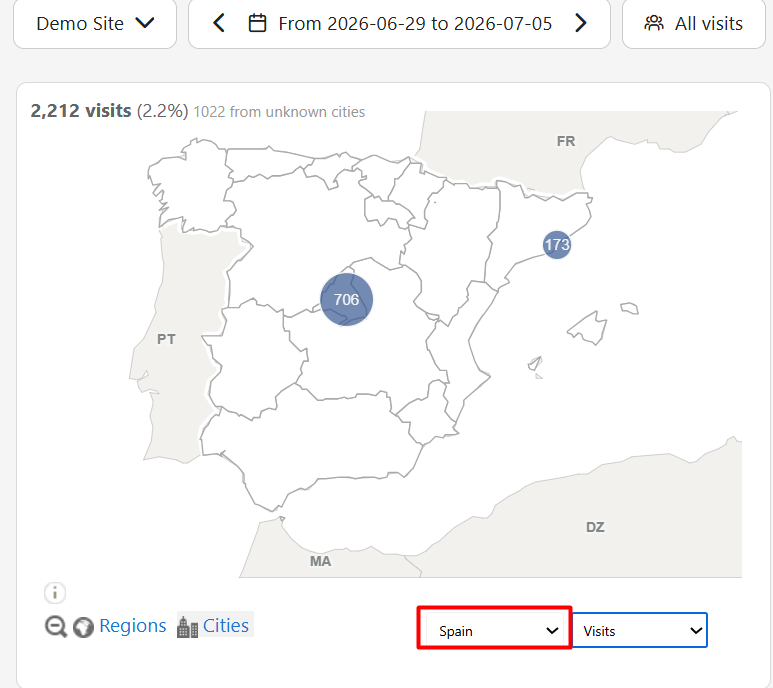

  1. City-level bubble view (circles sized by visits/population)
    This is available natively in Matomo, but only once you’ve drilled into a specific country, not at the worldwide level. To reproduce it:
  • Go to Visitors > Locations
  • In the country dropdown below the map (it shows “Worldwide” by default), select a specific country
  • The “Cities” toggle (bottom-left of the map, next to “Regions”) becomes active, click it to switch to city bubbles for that country
At the worldwide zoom level, this toggle is disabled by design; Matomo’s map only exposes the city/bubble view per-country, not globally. So we can get you exactly this bubble style, just not with all countries showing at once out of the box.
