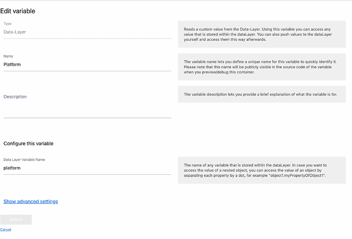

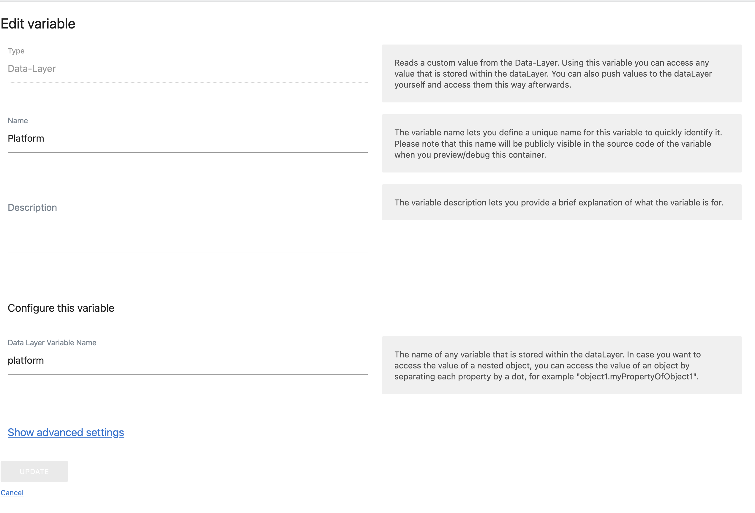

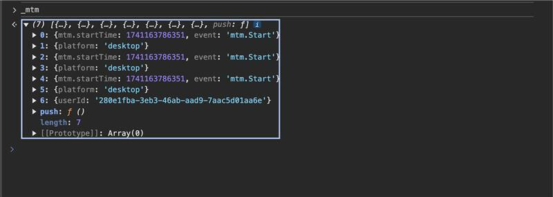

Hey, everybody. I can see on my site that the value of variables is not empty. But in data-layer in debug mode I can’t get them. My variables of data-layer type are empty. I am attaching the variable setting. Help to understand the essence where to pay attention to solve the problem please? Maybe I should add more info… Let me know

Don’t know for sure about Matomo Tag Manager but I can tell you that with GTM you cannot/won’t fetch dataLayer variable values unless there is an “event” value with the dataLayer push.
E.g. :
event : ‘platform_details’
platform : ‘desktop’
Try adding an event value to each and it should work.
