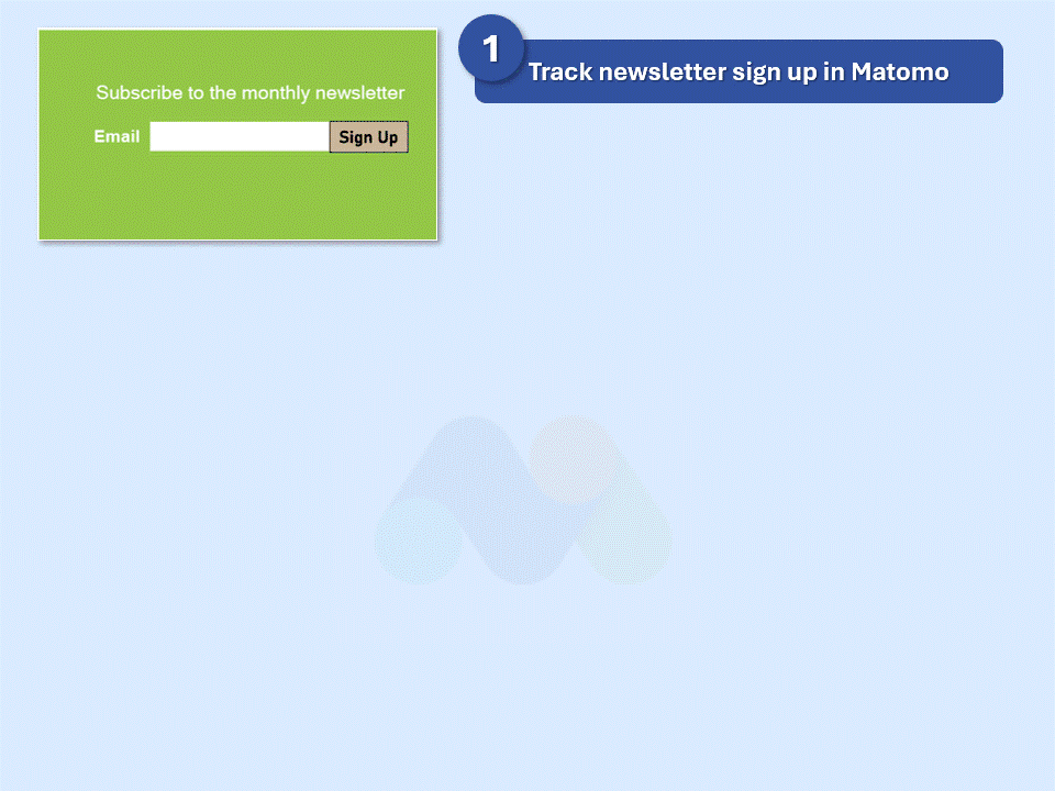

When to work with MTM and GTM:
  • GTM not installed: Use _mtm only for all event tracking.
  • GTM installed, MTM sync disabled: Push events manually to both dataLayer and _mtm if you want both platforms to track the same interactions.
window._mtm = window._mtm || [];
window._mtm.push({
  event: 'newsletterSignup',
  formLocation: 'homepage',
  userType: 'guest'
Brilliant - Thank you!!!
That works
