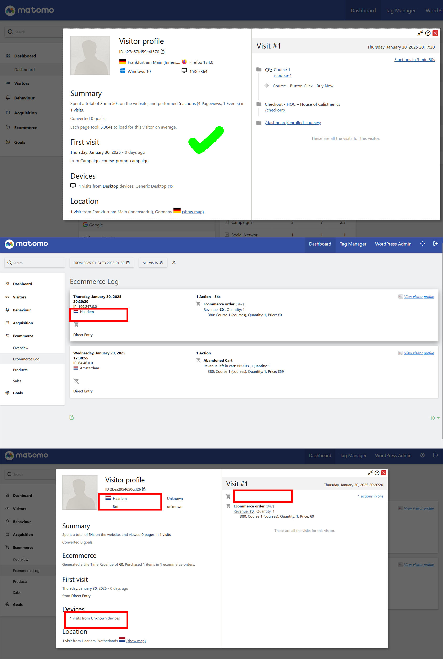

Matomo doesnt show the correct visitor profile data in the Ecommerce log.
When I do a test purchase of a product I can see the correct visitor data of the visit in the Matomo → Visits Log (country, entry channel and actions on the page).
However, when I go to the Ecommerce Log to look at the visitor profile of the sale, which should show the same data, the country of the visitor, for some reasons, is always shown as Netherlands (although, as you can see on the Visitor Log it’s supposed to be Germany in this case) and entry channel and page actions are missing entirely.
(I also noticed that the “ecommerce purchase” action in the visitor log is missing which I think should be displayed there no?)

So I found out that what caused this behaviour is the Matomo option “disable cookies”. If I disable this option (and allow tracking through cookies) it works well.
However, I’m trying to run Matomo GDPR friendly so I would actually like to keep cookies deactivated. I reviewed Matomo’s mysql tables and found out, that when cookies are allowed, the visitor ID in wp_matomo_log_visit (idvisit) is the same as the visitor ID in wp_matomo_log_conversion. So the two entries are connected. On the other hand if activate cookieless tracking the entry in the visitor log and the entry in the conversion log have a different idvisit and therefore aren’t associated.
I assume this is a bug in Matomo and hope it can be fixed or a workaround can be created. Thank you!
