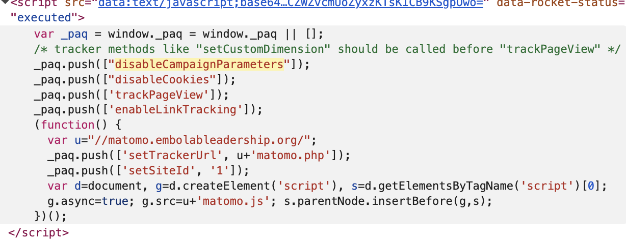

URL: embolableadership_org / self-limiting-beliefs/?mtm_campaign=belief_carousel_linkedin

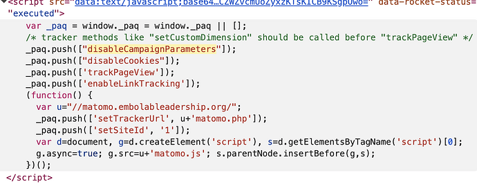

Just spotted the config in your tracking snipped. Without it, it should work. I tried with a patched version and at least the tracking request did contain the mtm param.
Just remove: _paq.push([“disableCampaignParameters”]);
Let me know if this helped resolve it! :slight_smile:
OMG! Many thanks! This is surely the problem. Will test it now. Thank you!
Update: its working :slight_smile:
Awesome! Glad it worked.
