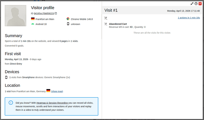

I’m currently testing Matomo for a WooCommerce site and have also purchased the “WooCommerce Analytics” extension for it. So far, everything is working, and I can see the correct sales figures in Matomo. But I can’t explain all the abandoned carts. They usually look like this example here:
These are always direct visits, without the user having viewed a specific product. I also don’t see any products that were previously in the shopping cart. The device’s resolution is also unknown.
How can these abandonment cart cases be explained?

Small update in case someone runs into the same thing. It wasn’t bots in my case.
It was the WooCommerce PayPal Payments plugin. To show the PayPal buttons on the product pages it runs a “cart simulation” (an ajax call to ?wc-ajax=ppc-simulate-cart) that adds the product to the cart and removes it again. The WooCommerce Analytics extension notices that cart change and logs it as a cart update, so you get a load of “abandoned carts” with no product, unknown resolution and direct as the source. It happens server side without client hints, that’s why the device info is empty.
I only found it after turning on the logging in the extension, every request was hitting ?wc-ajax=ppc-simulate-cart.
One filter fixed it (I dropped it in a small mu-plugin):
php
add_filter( 'woocommerce_paypal_payments_simulate_cart_enabled', '__return_false' );
Disabling the simulation doesn’t affect the actual payments (PayPal support confirmed that), it’s mainly for the Pay Later stuff. No more fake carts since.
