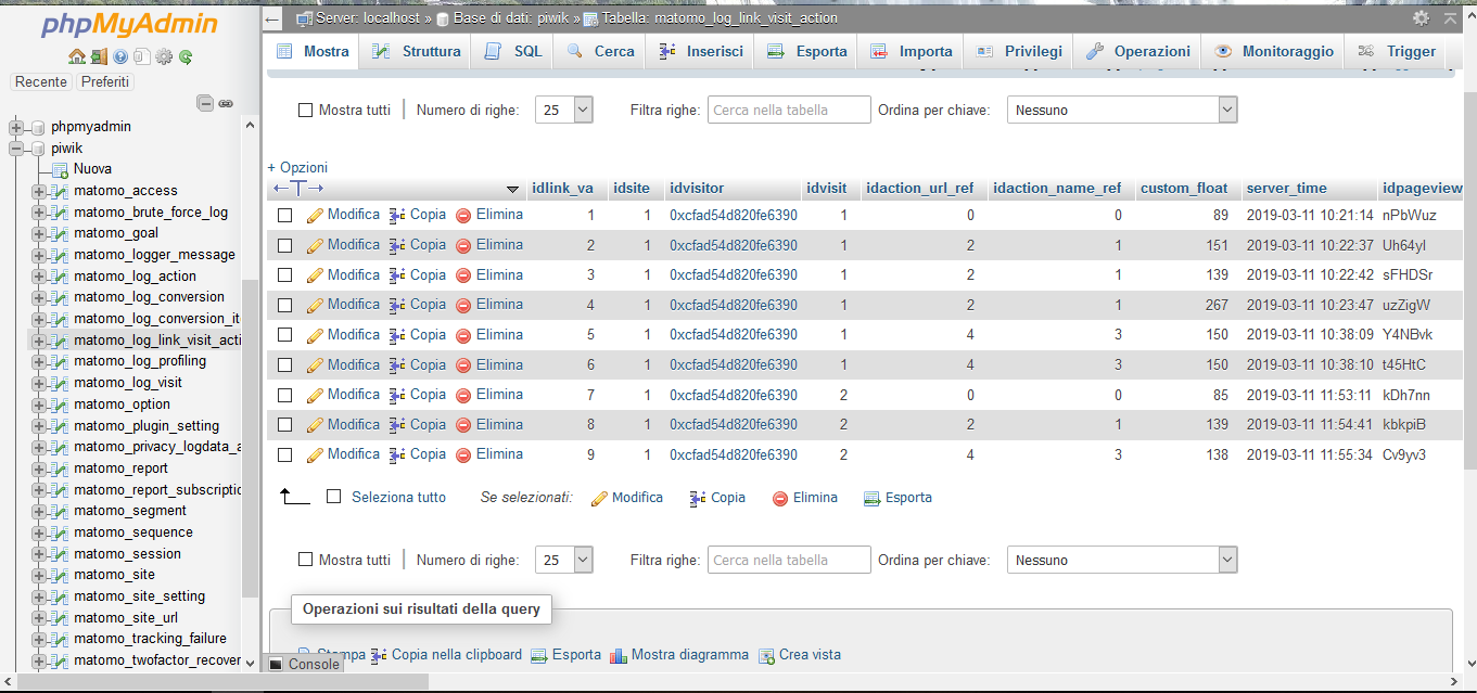

but in the database there are the data of the visits log
