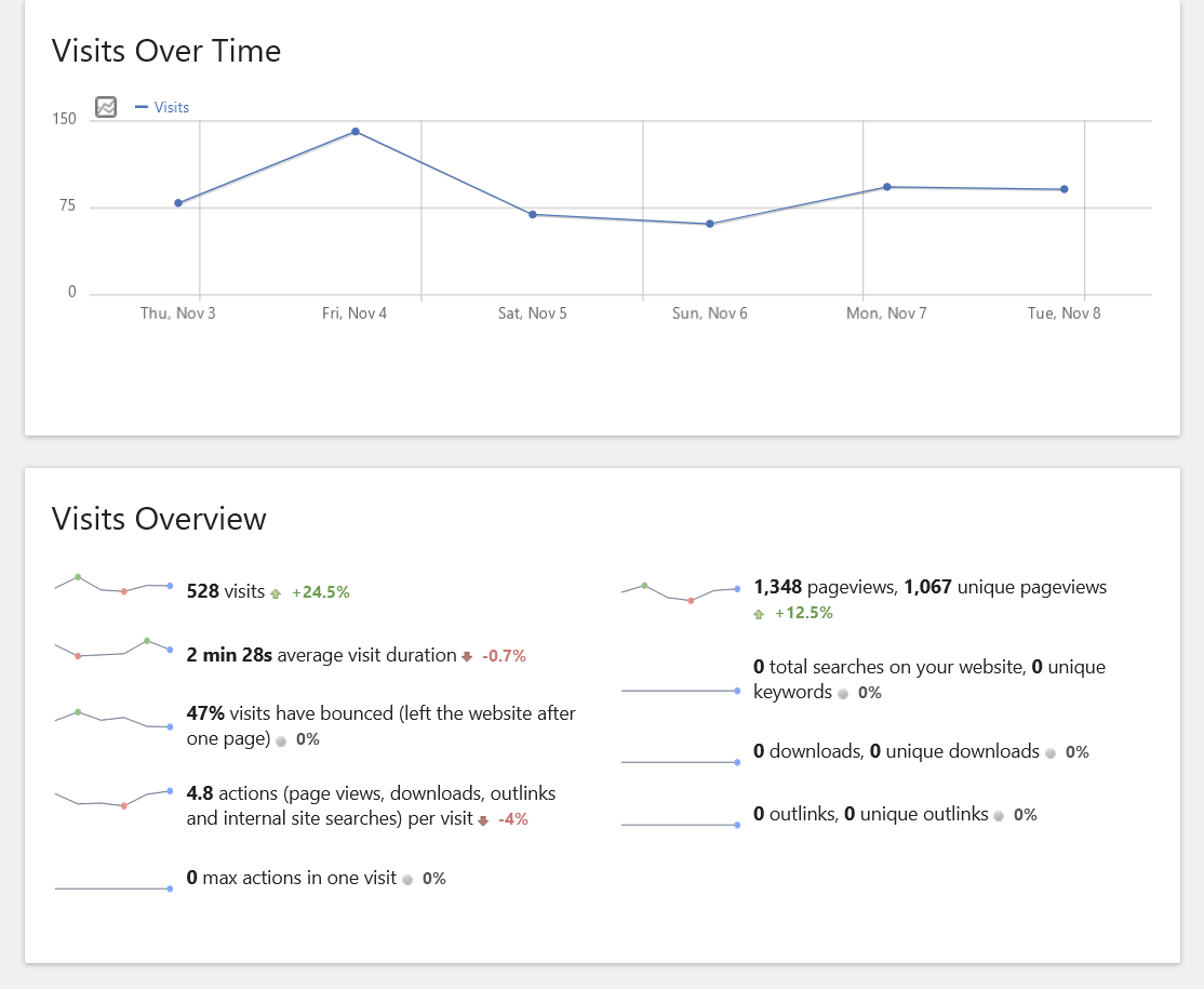

I have imported Google Analytics data from 2007 up to half of 2023 and I am seeing weird behaviour from the core:archive. When it ran it shown 0 total visits for most weeks (but not all).
There are now weird stats when viewing it.
If I view up to 6 days it seems ok.
But if I add just one more day to it then the aggregated drops to 0 most of the time (BTW I guessed that it is using incorrect week data, but the range is from Wednesday to the next Tuesday, more precisely 2016-11-03 to 2016-11-09):

For comparison, this is a view of 6 days (same day as in the original post, just one day less). You can see the totals are correct.

For the behavior of Aggregated Overview, it seems there is indeed a bug somewhere.
