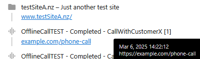

This would add an event to the existing visit.
e.g.
A token auth generated from a Super User would be required when sending a tracking request using the cdt parameter for dates older than 24hrs. The cdt would also need to be in UTC time.
