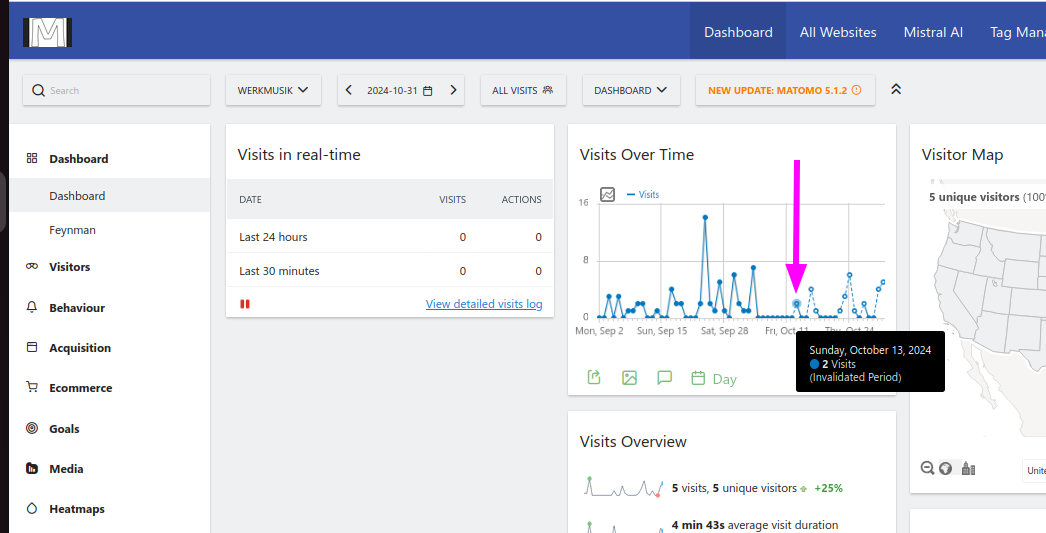

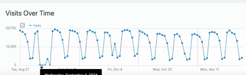

Related to "how do I tell if the archiver ran? How do I tell that Raw Data got turned into Report Data?
  1. In the Matomo interface watch for flatlines or too-low spots in your usual pattern.
  2. In the Matomo interface look for hollow dots. They are hollow to show that a “invalid” tag is lingering on that day/week/month/year. Every time core:archive does its archiving, it grabs a list of the invalid report times and should fix these, so they shouldn’t linger in this hollow state. If they do, it shows that the archiving for that period is crashing or somehow being skipped. Look up invalidate in the docs for some context.
  3. Daily or weekly check your error logs from archiving. The php console core:archive runs at the PHP-CLI module. To find where it logs its errors, check php -i | grep -i error. And your cron has error reporting in its output - look in your cron job definition.
