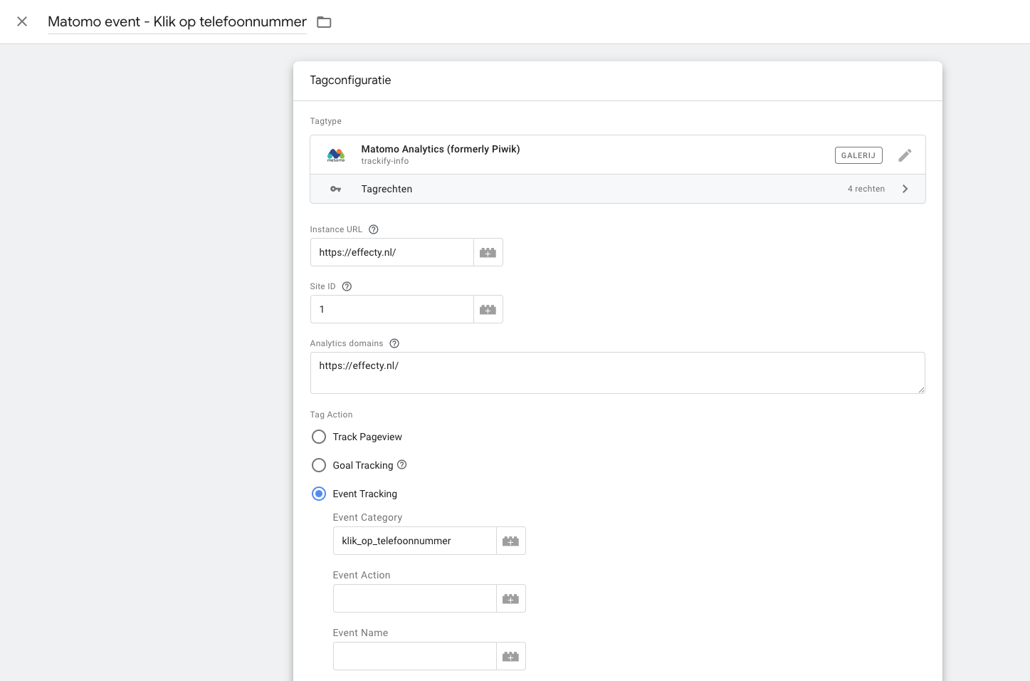

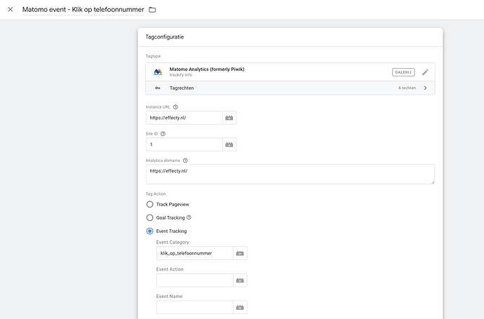

Hi,
See the images below for how I made the event in GTM (in Dutch though). This should normally work, right?
Hi @SjoerdvdBro
This seems good (I have never used GA), BUT the Event Action is mandatory (and then is missing…)
Hi Philippe,
Ah okay, I will try if it works if I add this. Thanks!
