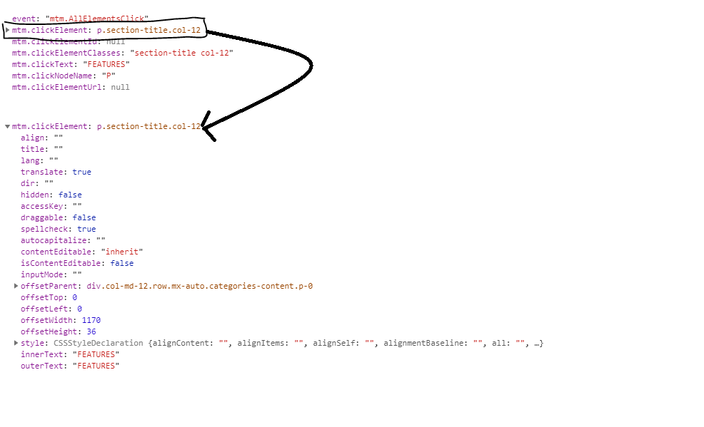

Hi I face a problem in retrieving the mtm.clickElement Breakdown
This is what i get in preview mode and console
The question is, why I got an empty set in preview mode ?(as well as in Matomo Tag manager)
At the same time, I tried to retrieve the data through tag custom variable, what should i input for get the mtm.clickElement details ? (i.e. src, href)
Thanks in advance

What I want to do is to extract the details within the mtm.clickElement
For example, offsetparents & imgsrc etc…
So my question will be how to capture the clickElement details in matomo tag manager, seems it is empty in preview mode.
In addition attached the preview mode for your reference
You can see the mtm.clickElement is empty

It may show as empty but actually the element may work. Could you check whether the element is really empty or not, in the datalayer by calling MatomoTagManager.dataLayer.get('mtm.clickElement') in JavaScript?
@matthieu please find the screen cap below
