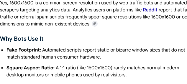

I have 38.000+ records from visits with 1600x1600px resolution which I expect are spam visits. Can I simply delete these records and will history be updated automatically? If not, what is the best way to approach this issue?
I would not delete all 38,000 records based only on the 1600×1600 resolution. First confirm they’re spam by checking IPs, user agents, referrers and visit patterns.
