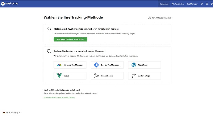

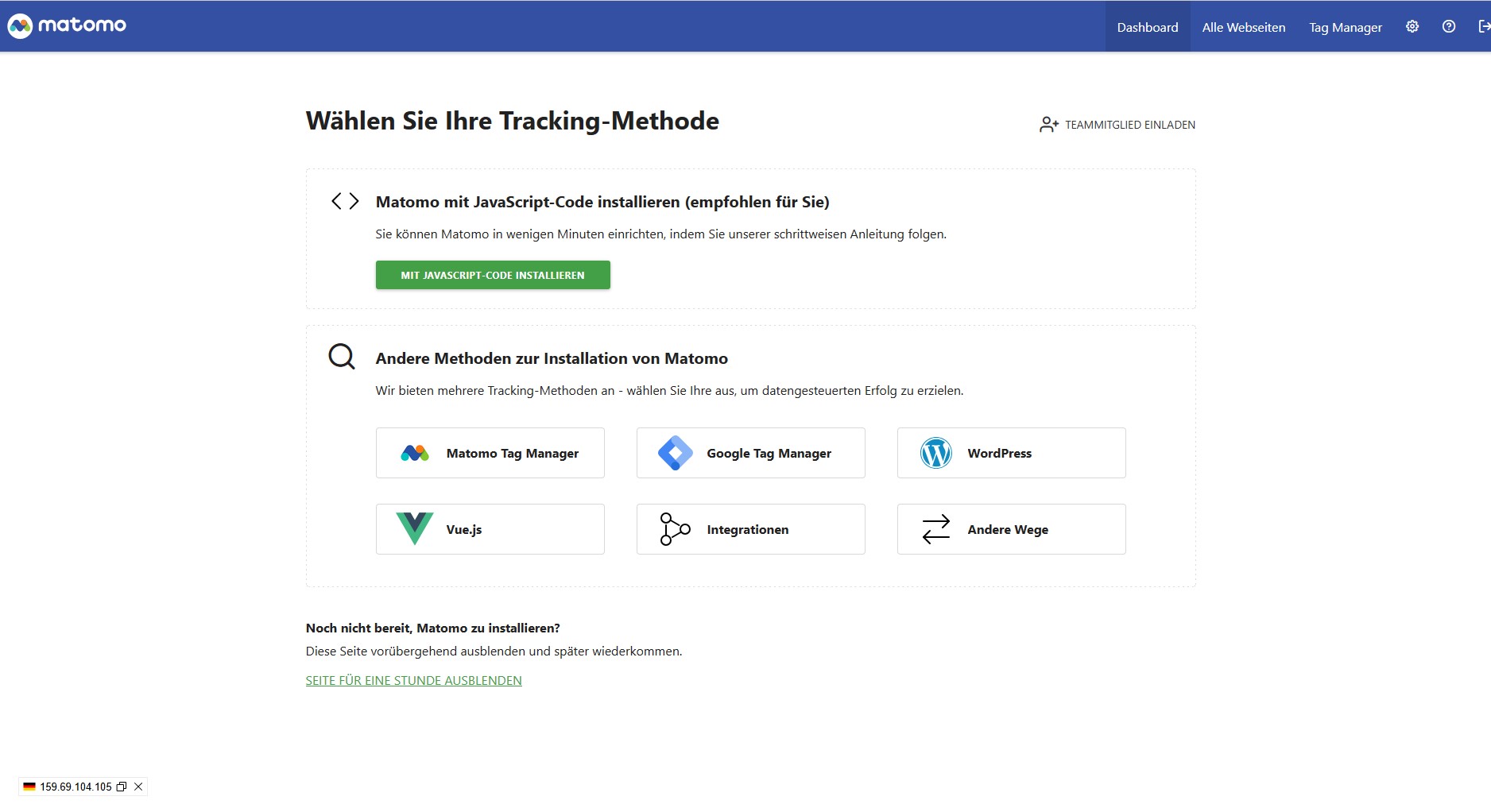

Dashboard always shows "Choose method" although already verified
Hi
i already added the Tracking code to my page and Matomos test (if the code exists on the page) was accepted / sucessfull.
Nevertheless i get always that starting page where i am told to choose a tracking method.
Its like a runaround and i have no option to skip it.
If i go to “All Websites” and cklick on my website i end up again on the dashboard
What do i have to do now?
Kind regards
axel

Hi Axel,
That page will normally show by default until some data has been tracked.
You can bypass that page by clicking a link located at the bottom of the page.
From your tracking code, the only problem I see is the back ticks around this part var u="``//matomo.diaboloqueen.com/``";
If you adjust this to be var u=“//matomo.diaboloqueen.com/”; does that help get the tracking working?
