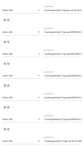

Here’s a screengrab of some of the expressions for the dimension in Matomo:
EDIT: Another question: I see you used an exclusion (^). The last time I tried one of those, Matomo wouldn’t accept them. Has that been corrected or is this simply a difference between goals and dimensions (like e.g. +)?
Hi @vanye
If regular expression doesn’t work as expected (eg. exclusion doesn’t work), you should create a ticket in the GitHub repo:
But first you should try if this work as the capture of all except the amperstand should work better than the capture of a complicated list of chars :wink:
If I understand well your problem, you created 15 action dimensions based on the capture of URL parameters thanks to regular expression.
Did you try if, for each custom dimension it could work “alone” or not ?

Hi @heurteph-ei
I created 20 expressions for this one dimension. I did not try them single yet, as I think that the pattern by which they work or don’t is clear.
But you are right: to properly test is always key, so I’ll try this and delete some of the expressions to see if the others work then.
You see, this is the thing that I find so irritating: The expressions are all basically the same, but only some of them work. To me it looks as if Matomo cannot tell them apart if they are too similar.
Hi @vanye
As previously written:
If multiple extractions are defined, the first extraction that matches is used.
Then if you have * .../suchergebnisse\?not-to-be-captured&groups%5B0%5D=to-be-captured-0&groups%5B1%5D=to-be-captured-1&groups%5B2%5D=to-be-captured-2 (and I think that in case of groups%5B2%5D you always have also 1 and 0), then only groups%5B0%5D=to-be-captured-0 will be catched…
