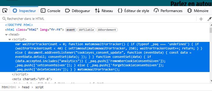

4/ I created a new Tag “HTML Tag” nammed CookieYES CMP in which I copied the consent script (with the Head start position) linked to “DOMReady CookieYes” trigger.

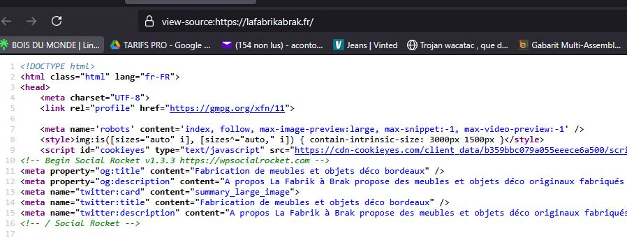

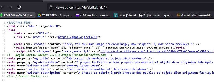

However, when the cookies are deposited and I look at the source code of my page, the code inserted in the cookieYes CMP tag (the consent code below) does not appear in the code. is this normal? I understand from the linked document that the code should appear when cookies are deposited. Is this correct?

  • If you followed the FAQ precisely, the code from the CustomHtml tag should be inserted at the top of the <head> element once the DOM has loaded. If you’re seeing the cookies get deleted when they’re supposed to be, chances are that the code was added to the DOM, just in a different place than you expected.

  • The CustomHtml tag is indeed inserted at the very beginning of <head>. I can see it in the browser’s devtool (F12)
    But when i open the code view-source, it doesn’t appear
Is this normal ?

  • Yes. It is expected to see the inserted code in devtools and not when viewing source. This is because when you view source, it shows the page as it was when the server sent it to your browser and the CustomHTML tag doesn’t insert the code snippet until after your browser has loaded that source.
