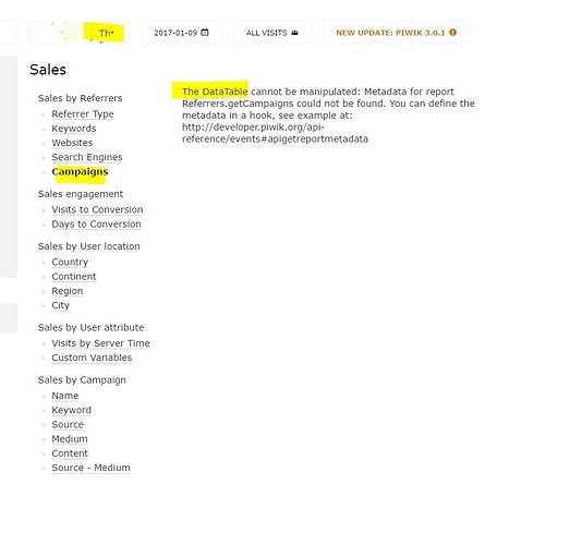

Cant revert back to hierarchical report after clicking on flatten report
Hey,
In eCommerce —> sales → campaigns
I clicked on flatten report
I got this
The DataTable cannot be manipulated: Metadata for report Referrers.getCampaigns could not be found. You can define the metadata in a hook, see example at: http://developer.piwik.org/api-reference/events#apigetreportmetadata
my problem is that I can not revert back to hierarchical reports
My piwik has many ecommerce sites i manage with a lot of data
How can I revert back to hierarchical?
Thanks
This is the screen I am getting
Issue was solved after a few hours -
i got the flat tables and was able to revert back to the Hierarchical
Hey @Yonatan_Ido, how did you solve it? I have the same issue, see screenshot
here, the error message I get on top of the page:
I have Piwik 2.16.0
Hi there, please upgrade to Piwik 3 where this issue should be fixed :+1: let us know if you have any feedback
