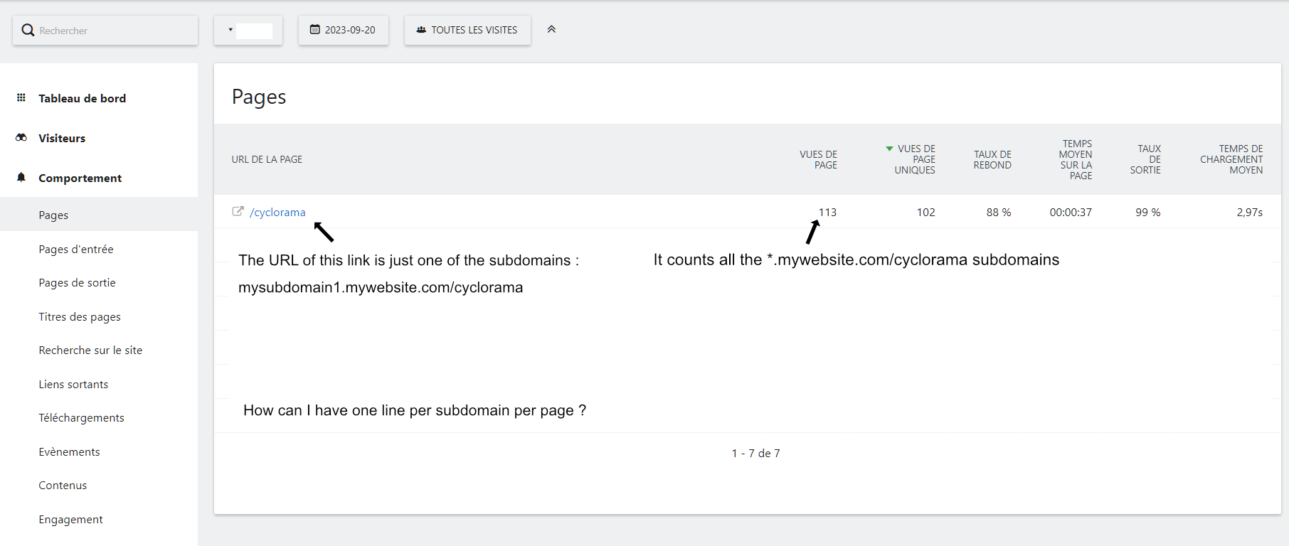

Hello,
First of all, thanks for this wonderfull tool !
I have a website with a wildcard subdomain, and the page view count don’t dissociate the subdomains.
The url of the page points arbitrarily to one of the subdomains.
Is it possible to dissociate the subdomain’s page ?

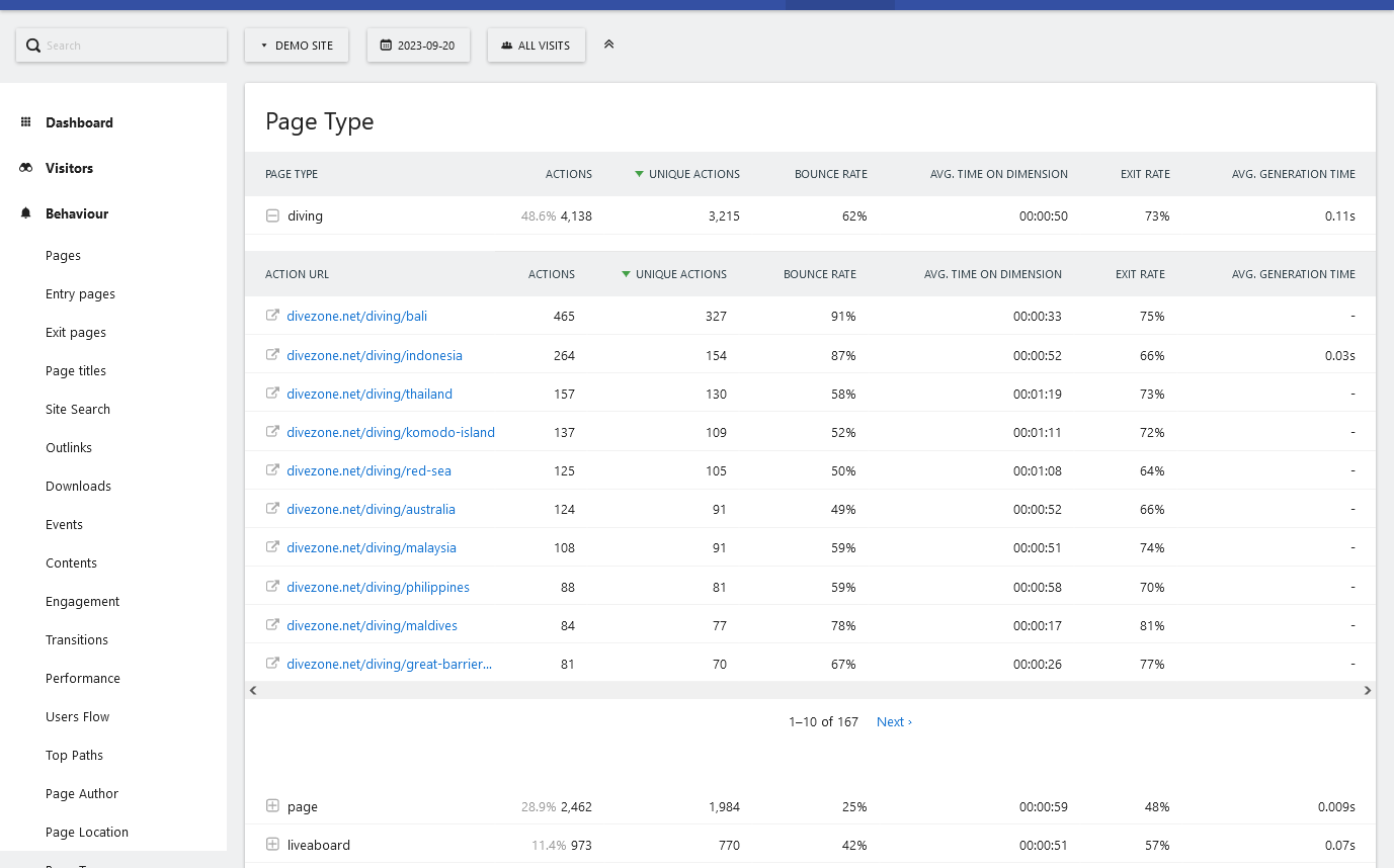

Another way could be to provide an action dimension containing the domain. Then you can have a vision to viewed pages per domain:
Example considering the Page type is the domain:
From:
