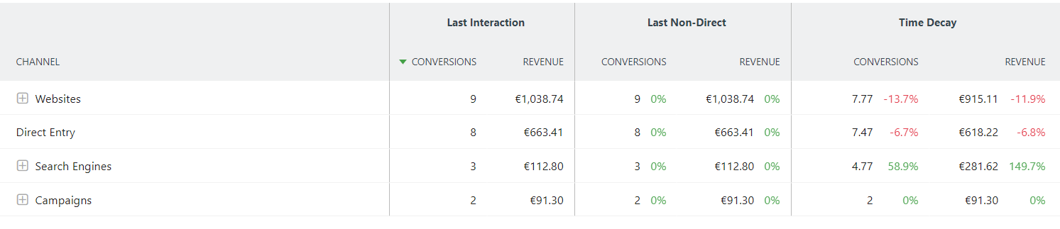

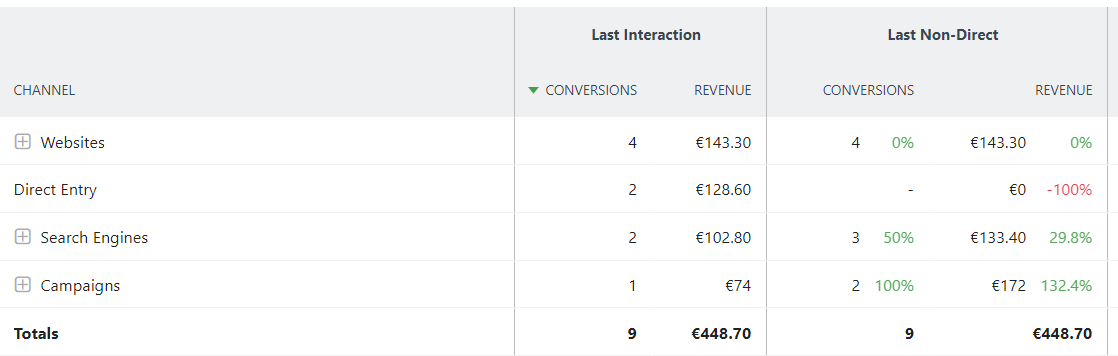

I have installed the premium feature ‘Multi Channel Conversion Attribution’ 3 days ago.
Unfortunatly, the ‘last non-direct’ attribution model is attributing some conversions to ‘direct entry’.
How can i correct that ?
here is a screenshot :

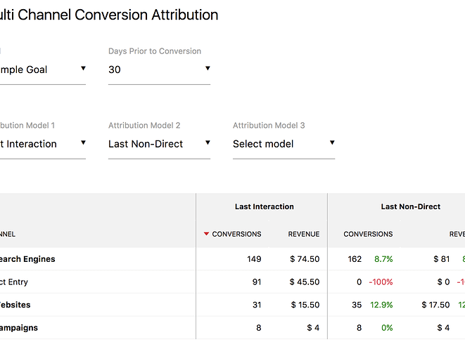

So why on my Last Non-Direct Interaction I have 5 Direct entry ?
Isn’t that the opposite of the FAQ ?
Even on the screenshot of the documentation, we can see that the Direct entry is 0 here :
