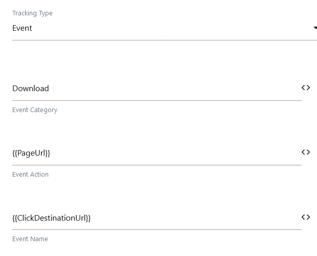

You could use Tag Manager and Event Tracking to track the page URL of any downloads moving forward.
For example if you have an Event Tag configured as below:
{{PageUrl}} will show the pageURL the download is occurring on when this Event is fired.
{{ClickDestinationUrl}} will show the filename of the file that is being downloaded when the download link is clicked.
The trigger can be set based on ‘All Downloads Click’ this would then fire the tag based on the file extensions listed for this trigger.

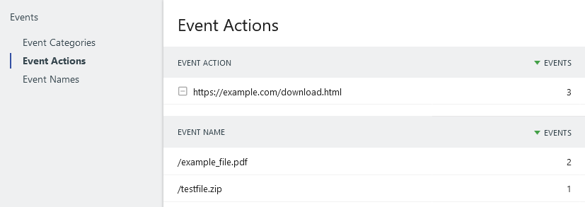

This would trigger an event when a file is downloaded similar to below.
The Behaviour > Events report would then show you the PageUrl and file that was downloaded.
e.g.
