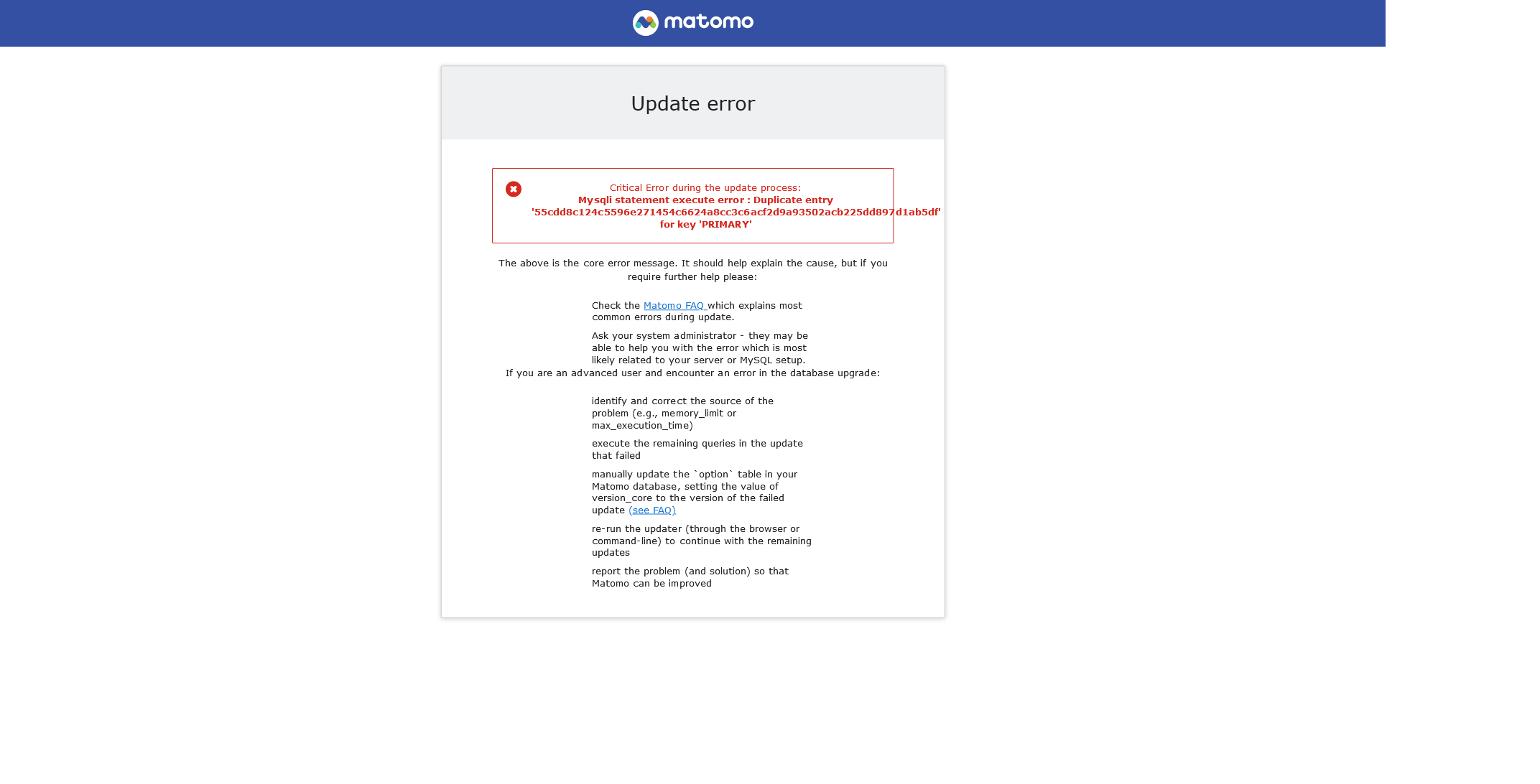

Hello,
I was in the process of upgrading Matomo from 3.14.1 to 4.0.1 on Cento… s 6.9 with PHP 7.2.24, MYSQL 5.5.62, Apache 2.2.34.
However when I click on 'Upgrade Matomo', I get the following error i.e :
Critical Error during the update process:
Mysqli statement execute error :
Duplicate entry '55cdd8c124c5596e271454c6624a8cc3c6acf2d9a93502acb225dd897d1ab5df' for key 'PRIMARY'
Here is the attached screenshot of the same :
Could you please replicate and fix this issue?.
