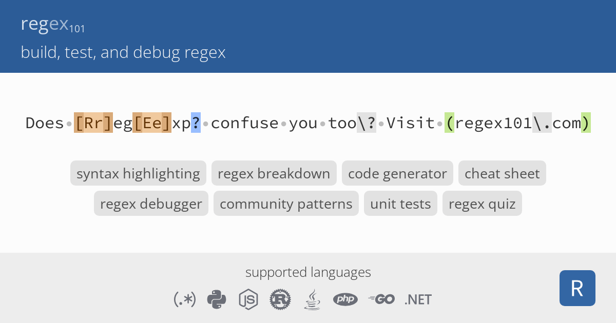

Hi @felix1
I tested through
And it seems this should work…
