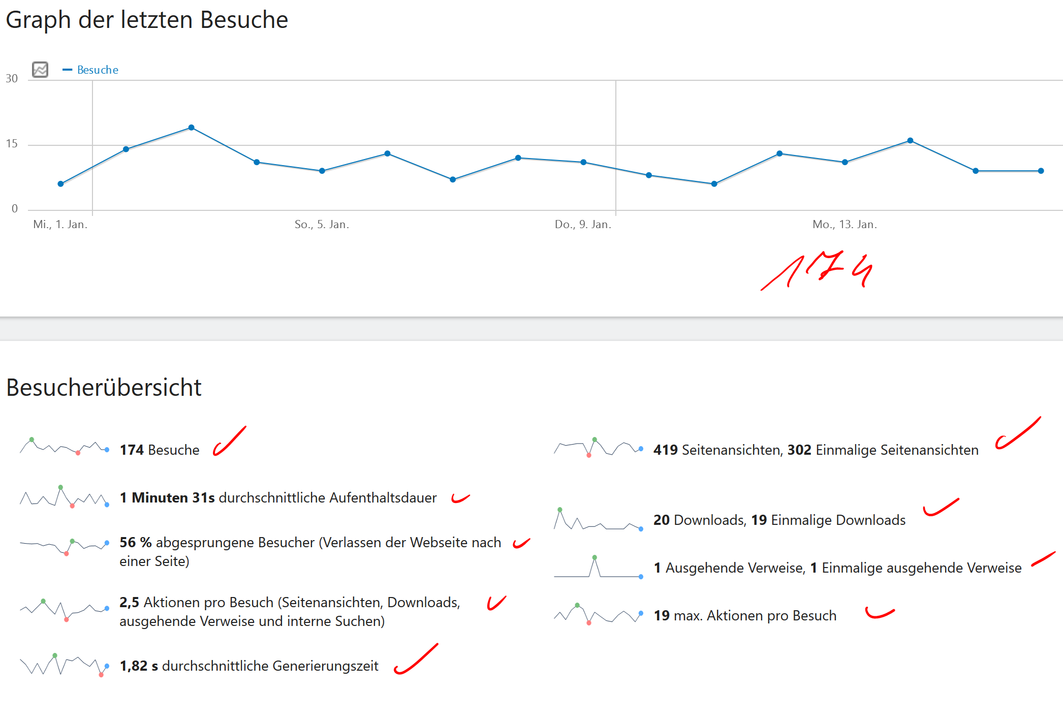

Step 1:
I’m going to call up a past 7-day report (2012-11-01 to 2012-11-07). What you see is the correct representation - both in the graphic and in the summary

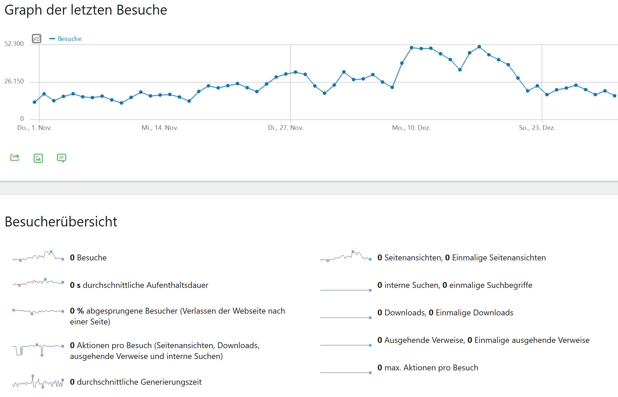

Step 3:
Now I am extending the report to 2 months (2012-11-01 to 2012-12-31). The graphics are correct, the summary is totally incorrect.
