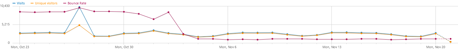

I’m banging my head against the wall trying to resolve an issue w/ bounce tracking. It “was” working. Then I tweaked some setting and our bounce rate has gone from typical, to impossible. Our typical bounce rate is around 80%. After whatever I did, it’s now 10%. I’ve looked at everything I can look at to figure out what I’ve done.

I’m looking at our ‘entry pages’ and the bounce rate for nearly everything is 0%. This is almost exclusively on category pages of our ecomm site. When I load any of the pages, I do find the tracking code (listed below) in the view source.

Bounce rate should not change when you update the code. It is calculated if a visitor visits just a page and do not trigger an event on it. Maybe you changed the tracked events on pages, then this can change the bounce rate…?
